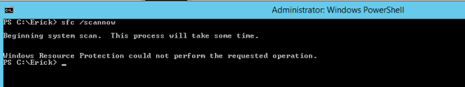

Hello! So I have a server 2012 R2 std. version 6.3.9600 N/A Build 9600.
The history for the server is that, is a domain controller on 2014 I remove the GUI to server have only server core doing the normal process, the change work normal and I have the server only on server core but do not work anymore to install windows update, I try to return that to have GUI but that don't work as well anymore because give error and don't work. since 2014 I stop many times to try check a way to make the server update the windows update and all the time that fail, with a ticket with Microsoft premier support they told me I should reinstall the server to get that back to work :) but I can't do that for that server, so I hope can get a help from you guys, that is my last hope! :D
sfc /scannow fail
The SFCFix show the error message 14098, the component store has been corrupted.

Hi and welcome to Synative,
Unfortunately your COMPONENTS hive is corrupt beyond repair. It's completely empty and can't be reconstructed. Sorry for the bad news.
