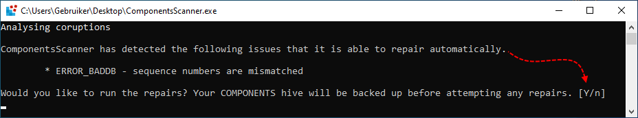

Step 1. Upload your COMPONENTS hive.
  • Navigate to C:\Windows\System32\Config and locate the COMPONENTS file.
  • Right-click on this file on your desktop and select Send To > Compressed (zipped) folder. This will create a file named COMPONENTS.ZIP on your desktop.
Step 2. Download
ComponentsScanner and save it to your desktop.
  • Right-click ComponentsScanner.exe and select "Run as administrator", click Yes on the UAC (User Account Control) prompt which appears.
  • Follow the on-screen instructions.
  • When the following message appears: "ComponentsScanner has detected the following issues that it is able to repair automatically."
  • Press Y to perform the repair.
  • Once complete, a report will be saved to your desktop called ComponentsScanner.txt.
  • Post the logfile ComponentsScanner.txt as attachment into your next reply.
Here are the files requested:
ComponentsScanner Version 1.5.1.0 by sysnative.com
Windows Version: Windows Server 2019 Standard x64 (10.0.17763.1879)
Start time: 2022-09-20T09:08:34
Hive scanned: %windir%\System32\config\COMPONENTS
Number of keys: 125192
Number of values: 304892
==== Critical Errors ====
Hive failed regedit load test with error ERROR_BADDB: The configuration registry database is corrupt.
==== Corrupt Key Names ====
None
==== Corrupt Value Names ====
None
==== Corrupt Value Data Type ====
None
==== Corrupt Value Data ====
None
==== Repair Log ====
COMPONENTS hive backed up to C:\Users\aecoles\AppData\Local\Sysnative\ComponentsScanner\COMPONENTS\filj0bt4.js5
==== Repairs Attempted ====
Repair Type: ERROR_BADDB
* Pre Repair Stage: Nothing to do
* Repair Stage: Successfully updated primary and secondary sequence numbers to 138240
* Post Repair Stage: Hive successfully loaded in Regedit without error
==== Warnings ====
None
Storing 58458.11KB in C:\Users\aecoles\AppData\Local\Sysnative\ComponentsScanner
Finish Time: 2022-09-20T09:13:42. Corruption scan time: 275.1472124s
===========================EOF===========================
The COMPONENTS hive is succesfully repaired, please try to update Windows, if it fails attach a new copy of the CBS log.
