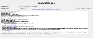

hi everyone i really struggle with Microsoft .Net framework 4.8 installation on windows 8.1, my visual studio is 2015 version with .net framework 4.6. my last project require Microsoft .Net framework 4.8 to run new framework, the problem look like this pic
Is it possible that my installation steps are not quite right, I've tried several ways from installing the program f# 4 Runtime , offline installer .Net Framework 4.8 and the error still occurs. is there another way I can try, so that .net framework 4.8 is successfully installed,here are some of my steps that are still error, maybe it's not right or there's something else I have to do

Provide the Components Hive
1. Navigate to C:\Windows\System32\Config and locate the COMPONENTS file.
2. Please copy this file to your desktop.
Note: If you receive an error that this file is in-use, simply reboot your computer and try again. Note: If you find that you need to reboot and are unable to because this is a server then try Option#2 below.
3. Right-click on this file on your desktop and select Send To...Compressed (zipped) folder. This will create a file named COMPONENTS.ZIP on your desktop.
4. The file will likely be too large to upload here so please upload to Filedropper or WeTransfer and just provide the link here.

Follow the instructions below please.
WARNING! The following fix is specific to the user's system in this thread only. No one else should follow these instructions, as it could damage your system.
  • Download
    SFCFix and move the executable to your desktop.
  • Download the attachment SFCFixScript.txt and save it on your desktop.
  • Open the file, then copy and paste its content in your next reply.
SFCFix version 3.0.2.1 by niemiro.
Start time: 2021-06-16 22:34:27.230
Microsoft Windows 8.1 Update 3 - amd64
Using .txt script file at C:\Users\Windows_8.1\Desktop\SFCFixScript.txt [0]
RegistryScript::
Successfully took ownership and permissions for registry key HKEY_LOCAL_MACHINE\COMPONENTS\DerivedData\Components\amd64_microsoft-windows-t..localsessionmanager_31bf3856ad364e35_6.3.9600.16384_none_96032ccbde81b601.
Successfully imported registry key HKEY_LOCAL_MACHINE\COMPONENTS\DerivedData\Components\amd64_microsoft-windows-t..localsessionmanager_31bf3856ad364e35_6.3.9600.16384_none_96032ccbde81b601.
Successfully restored ownership and permissions for registry key HKEY_LOCAL_MACHINE\COMPONENTS\DerivedData\Components\amd64_microsoft-windows-t..localsessionmanager_31bf3856ad364e35_6.3.9600.16384_none_96032ccbde81b601.
RegistryScript:: directive completed successfully.
Successfully processed all directives.
SFCFix version 3.0.2.1 by niemiro has completed.
Currently storing 1 datablocks.
Finish time: 2021-06-16 22:34:27.578
Script hash: Ouq3waEOlsC44TK4rufucyHcsyGfxg46YhJ0JrnRQTQ=
ok, here we go...
Good. Try the .NET installation again and report the result.
