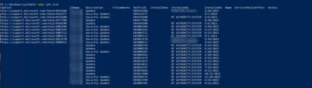

If it helps at all. Below are all updates that show installed when running "wmic qfe list"
