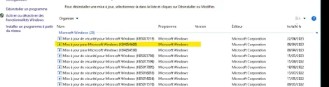

via CMD it doesn't work, it opens the window and closes without doing anything
I deleted it through the GUI, the line of this kb disapears
when i come back to the list the kb is there again

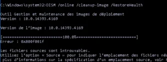

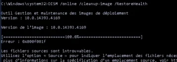

Okay, please run DISM again and post the new CBS logs.
