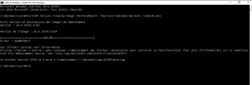

With the 2019 backup and this CMD
C:\Windows\system32>DISM /Online /Cleanup-Image /RestoreHealth /Source:H:\Windows\WinSxS\ /LimitAccess
Bruno
Regards

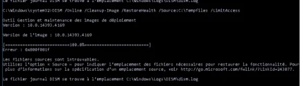

Step 1.
1. Please unzip SFCFix.zip to a new folder e.g. C:\Tempfiles
2. Run DISM again with that path as source:
DISM /Online /Cleanup-Image /RestoreHealth /Source:C:\Tempfiles /LimitAccess

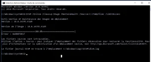

Yes, we'll need to replace a large number of files, and the CBS log shows only a shortened result with the corruptions so please provide the latest CBS logs.
Please do the same with the attached ZIP file.
Just extract the new files into the WinSxS folder to have a complete set of replacement files to backup later.
Please do the same with the next batch of replacement files.
P.s. no need to attach the DISM log, this file is not helpful at all.
