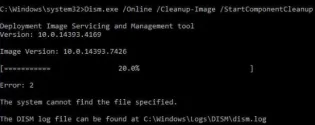

Sorry for the delay, I've tried both of these and neither seemed to fix the issue. I went through and ran additional SFC and DISM sessions and when trying "Dism.exe /online /Cleanup-Image /StartComponentCleanup" I was able to provoke another error getting the result "Error: 2". I've included another copy of the CBS folder.
Attach the file C:\Windows\Logs\dism\dism.log to your next reply.
Run the command Dism.exe /Online /Cleanup-Image /AnaLyzeComponentStore in an elevated commandprompt and report the result.
If it fails, provide a screenshot of the result and copy the file C:\Windows\Logs\CBS\cbs.log to your desktop.
Zip the copied file and attach the zipped cbs.log to your next reply.
Ok.
Run the command Dism.exe /Online /Cleanup-Image /StartComponentCleanup in an elevated commandprompt and report the result.
