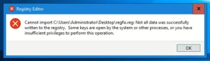

Ok, perform the following fix. More fixes are needed.
Download the attachment and extract it.
Open the extracted folder, double-click the file regfix.reg.
When prompted allow to change the registry settings.
Report the result.
So, this is what happened. Do I need to boot into safe mode or clean boot and then run it?
