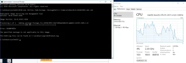

Hi Peter,
I have rebooted the Server and attempted the install and it has failed with the 0x800f081e error again, I have attached a screenshot and the latest CBS.

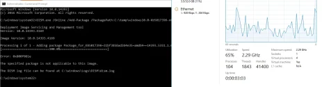

Hi Peter,
The installation has failed again with the same error, please see attached screenshot and CBS.
