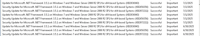

Hi
may be a long shot but i have a old server that we cant upgrade to anything newer and the same update reinstall each time we reboot. Everything seem to be fine with no error but after next reboot its install again
i run sfc , SURT and component scanner
thanks
Michael

this server didnt have love for many years so we are trying to fix them until we can remove it but its a legacy application so it will take time
Windows Update is set to download and install updates but apparently it doesn't.

we are using sccm to push updates but that server was not updated for a long time and we didnt purchase de ESU so we are not trying to installed or be sure that what can be installed as update are
Are the servers in both threads you started connected to the same sccm ?
yes they are both in the same, we have some other 2008 r2 that dont have any problem so not sure if its related to our sccm
i thin running the SURT have fixed something because after a reboot i dont see any pending or failed updates
so that one is good now
