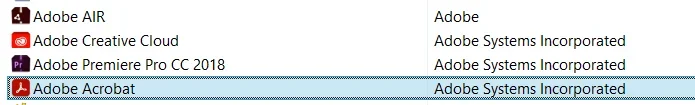

Do you use "Acrobat DC" ? If not, uninstall it.

When I click uninstall it just takes me to the uninstall software, but it does not list adobe DC exactly, it does list Adobe Acrobat though. I do use it, but if it's blocking me from upgrading I can temp uninstall it. I was able to select 'repair' like I did with one note, I am not sure the effect.

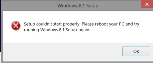

Try re-installing Windows 8.1 again.
If it fails attach the file C:\Windows\INF\setupapi.dev.log to your next reply.
Got past that, but still stuck. I don't have the log you asked for, but do have these. Error 32 ironically the same error that keeps me from updating my drivers.
Going to try again with out preserving my driver store (no worries I have full image back up) and see if that gets past things.
Nope, didn't change a thing - I suspect my driver store is fubared. I could just as well replace it with the contents from the install.wim ? I'll wait for your ideas :)

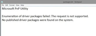

Run the command pnputil -e > "%USERPROFILE%\desktop\packages.txt" in an elevated commandprompt.
After the command runs there will be a file on your desktop named packages.txt.
Attach this file to your next reply.

The request was not supported error - maybe not on windows 8.1
Windows 8.1 should support it. Provide a screenshot of the error message.
The text file contained that note instead of the contents. I'm at work now but can get you the exact wording when I get home. There was not code per say just a sentence.
