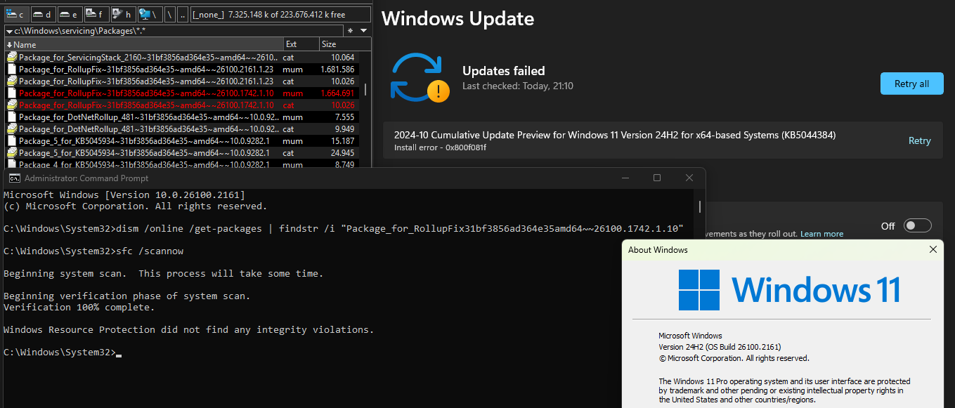

Well, it looks like I was wrong... So the fix I posted earlier isn't really a fix.
After a while, 0x800f081f error started to pop up again in Windows Update... 😟
System tries again to install KB5044384 and fails with the 0x800f081f error.
I've attached again latest logs from Windows + ComponentsScanner.txt
I created my own SFCFix with the two missing file, that MUM and CAT (see attached). And I applied succesfully the fix to SFCFix.
But this is not enough...
If I run this command:
dism /online /get-packages | findstr /i "Package_for_RollupFix31bf3856ad364e35amd64~~26100.1742.1.10"
I don't see the package installed.
How are we supposed to install this missing package? If I try to install the updates it will fail with errors like 0x80070002.
My guess is that some packages from latest updates were installed, but not this "Package_for_RollupFix31bf3856ad364e35amd64~~26100.1742.1.10".
And even if I want to install regular updates it will fail because it somehow detects the update(s) as installed. 🤔
Well... The error 0x800f081f is back! 😞
I also added latest logs.
Please help. 😭

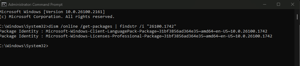

EDIT: I also tried to search packages containing "26100.1742":

My suspicion was that packages related to 26100.1742 were either misinstalled or not correctly recognized by the system. These problematic files were likely carried over during upgrades or were never successfully installed, leading to the same error repeatedly.
The following steps might work for you if you are running a build newer than 26100.1742 and your DISM.log shows something like this:
"Generating failure report for package: Package_for_RollupFix~31bf3856ad364e35~amd64~~26100.1742.1.10, status: 0x800f081f, failure source: Resolve, start state: Absent, target state: Staged, client id: UpdateAgentLCU".
