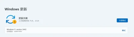

Hello, unfortunately, I tried installing the update via Windows Settings and the ISO, but both returned the 0x80070002 error code.
English translation to the 1st image: install error - 0x80070002
English translation to the 2nd image: The installation failed in the SAFE_OS phase with an error during INSTALL_DRIVERS operation
