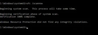

Thank you! The fix completed. We restarted the server and then ran SFC /scannow and it finished without errors. Please let us know the next step or if you would like to review the CBS logs.

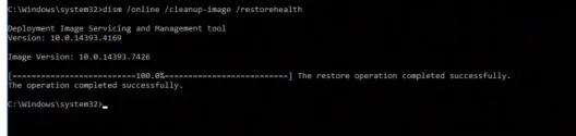

Great.
Run the command Dism /Online /Cleanup-Image /RestoreHealth in an elevated commandprompt and report the result.
If it fails, copy the file C:\Windows\Logs\CBS\cbs.log to your desktop.
Zip the copied file and attach the zipped cbs.log to your next reply.
You are amazing, Peter! May I check for updates, or do you have another idea in mind? This is the first time in months it has completed without error.
Great. Go ahead and report the result.
