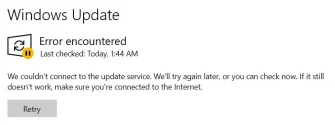

Hi..Win update is doing the same thing. I ran the troubleshooter and it came back that there are no issues. I also just noticed that I'm getting the same issue as the Windows update when I click on the news feed button that it can't connect to the Ms servers. Attached are screenshots.. thanks !

Copy the file C:\Windows\Logs\CBS\cbs.log to your desktop.
Zip the copied file and attach the zipped cbs.log to your next reply.
